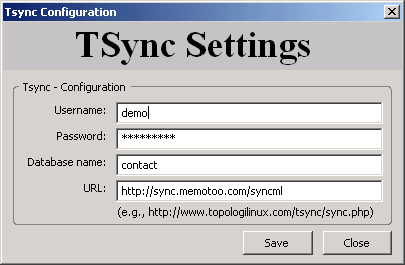

If you want to sync Memotoo with Thunderbird, I have just find a soft to sync your data who use the SyncML protocol
-> Tsync (version 0.2): http://www.topologilinux.com/syncml/
Settings:
More infos about Memotoo and SyncML:
-> https://www.memotoo.com/how-to-sync-your-data-with-syncml.php
